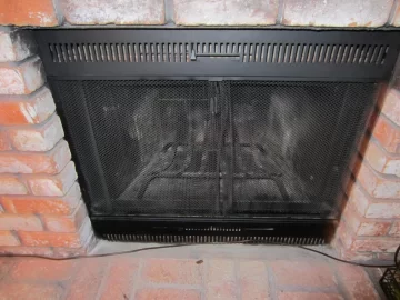

hi I've got a Preway BI36 - probably installed around 1979 that I want to add some glass doors. However, the bricks in the front of Preway around only 35" 1/4 wide, the frame is 36 ". No matter how I twist the frame, I can't get it past the bricks. If I could, I think the Preway is set back enough behind the bricks, that I think I could use the glass doors. I got the doors from bricks-anew and they appear to be very good quality, so I'd like to be able to install them..
So my question is, can I split the frames in half, wiggle them past the bricks and then splice them back together. I'm most concerned about safety, would the extra crack in the frames cause a problem. The frames aren't airtight by any means, so I'm thinking this is okay.
I would put the splice on the sides, about half way up so it wouldn't interfere with the rollers at the top and bottom of the doors. Attached a photo if that helps.

If you can get the doors on the unit, go ahead. Unless the panes in them are pyroceram, you will have to burn with the doors open anyways. Tempered glass won't hold up to the temperatures of a closed in firebox, so any gap is gonna pretty much be a non-issue.
