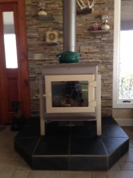

Thanks again everyone. Here's my stove/install
[Hearth.com] Help with Ideal Steel?
Thanks for all the great replies. I suspect that since the stove seems to work mostly as advertised sometimes that the problem is mine. I did just recently get to the part of the woodpile that has the oak mixed in (though I did measure that too after a fresh split: <20). Also, some of the pieces are larger than ideal, I think. I used to mix larger and smaller pieces because I needed the larger chunks to save coals overnight. Also, I split by hand. So, the wood may actually be part of the issue. Also, the chimbley. You'd think after I put so much time into the install that I would have checked to see if it was high enough. I did knock out a one-foot pice to raise the hearth ( and higher legs), but didn't think that would be an issue because my draft was so good before. I'll measure the outside length today and see if I can extend. Thanks for directing my attention there. It is cleaned out, as of the beginning of the season.
Part of my issue to is that it's been mild, mild mild, and then wham, below zero daytime for a week. So I wasn't really needing to test the stove, and, in this weather, I don't think any stove would heat my house adequately (2200 sq feet, lots of windows, high ceilings). There is definitely a lot more to think about with a cat stove.
Thanks again everyone. Here's my stove/installView attachment 149759
Your install looks great. Once you get that puppy figured out I'm sure you will be very happy.
