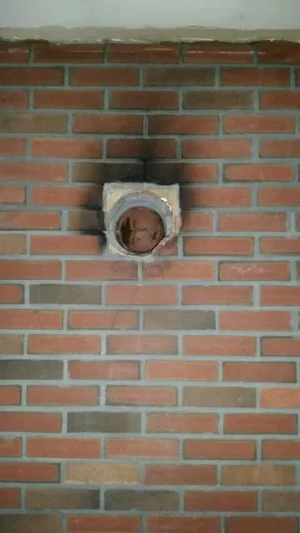

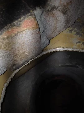

I bought a new wood stove...Blaze King Princess and it had recommended me to install double wall stove pipe. I looked at the pipe coming from the existing interior chimney where I had my last wood stove and decided to change out the pipe coming through the wall. Well, I opened up the brick and broke out the terra cotta lining and saw that the lining was sitting on drywall. Basically someone cut a hole in the drywall to place the terra cotta lining on it (with single wall pipe inside the length of interior wall, of course...pardon sarcasm) Is this safe? Where do I go from here? Do I install a wall thimble? Or what? Help me please..lol Pictures are coming in a second..new to forum.
Picture of new hole in brick I made today

Ya that doesn't look right. Plus new stoves require a stainless liner to be put into your chimney to operate correctly!
I would also assume studs aren't too far away since theirs drywall there.

You really should have a stainless 6" liner in the chimney for that BK. I would remove the clay thimble and replace it with a piece of class A chimney pipe, Then reline with an insulated SS liner.

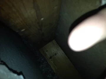

The sheet rock was holding the terra cotta wall thimble and then the studs are within a few inches of the hole.
Yes you will need to remove those studs and restructure if need be. Are the studs also in contact with the outside of the chimney structure?

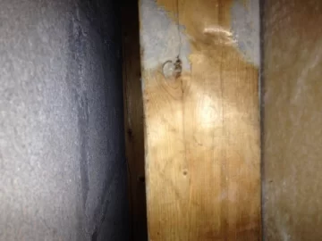

The wall stud is about an inch from the hole. I don't know if you can see but the stud is right there.
Yeah that will need to move. And it is in contact with the outside of your chimney as well. That tells me there is probably allot more wood touching it which means you should have an insulated liner as well. as a wall pass thru
We got about 2 inches from the wall stud to chimney.
ok it didnt look like that. If you can confirm you have that clearance the whole way up you are good as far as that clearance requirement goes.
