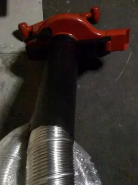

Yep the plan is to attach it to the top of the chimney and suck it out. Planning on slipping the blower nozzle over the 4' flex pipe and plugging the blower in from the ground. Checked the fit today and the Toro I bought fits perfectly over the 4" flex liner. Since you have a 3" liner you could probably need to get a rubber sewer line reducer at the depot to get a fit. Here's some pics I snapped when checking the fit.
  • [Hearth.com] Help with leaf blower trick
