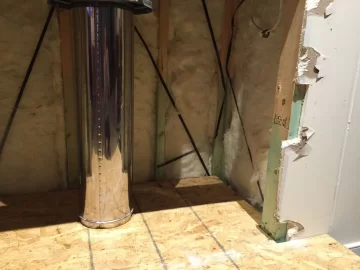

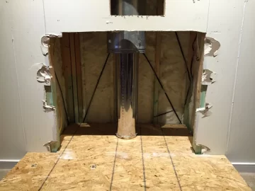

I've, like most, have trolled this site for years. Never posted, as most questions went answered. But now I am in a huge pinch.
We wanted to install a US Stove 2200i in our newer construction home where a zero clearance fire place once was. We are having the worst time finding someone to help us. Our usual contractor doesn't feel comfortable doing it but already took it apart. Separate discussion. ;
See the attached pictures and you can find the manual online (broken link removed to http://www.usstove.com/image/manuals/Wood/2200I.pdf) I think we are okay but.
My question is this. If we follow the combustion clearance on all sides can this just sit in the hole? In other words do I need to do anything with the surrounding area inside the 'chimney' buildout? Ignore the pipe.
Currently the inside box dims are 48" x 20". The frame can be changed but is currently 42" wide and 36" high. Appreciate any help. My wife doesn't want me to burn the house down. :)

Fireplace inserts like the US Stove unit you want to install must go inside a masonry fireplace or approved zero clearance fireplace. Inserts cannot just sit inside a wall cavity where a prefab fireplace was removed. Hearths also have to be made of non-combustible materials, extend a minimum of 16" - 18" depending on the stove manufacturer's specifications. It sounds like you should have left your original unit in place until you did some research to see if an insert would have been permissible to use inside it. The insert you mention is a very tiny unit at 1.2 cubic feet firebox. How did you plan to use the insert? If you just want to heat a small room or to just look at a fire this unit might meet your needs, but I doubt it could heat very much of your house. Good Luck sorting things out.

You could pick a freestanding stove, frame out the opening for its alcove clearance requirements, and install a new class A chimney.

I took a quick look at the manual just to make sure and I think you are certainly not ok. That unit can be installed in a masonry fireplace or inside the ZC fireplace that you had there before. It cannot just go in the wall cavity as is. If you still have the ZC fireplace from before you could check if the insert fits in there and if yes, try to re-install it and put the US insert in there.
A unit that would be permissible to install in the current location would be the Flame Monaco. It is an EPA-approved zero clearance fireplace. You may have to change the chimney pipe, check the manual and your current pipe.

You were given some bad advice; maybe they did not quite understand your question and assumed that you want to put the insert inside the ZC fireplace. Nevertheless, using an insert in a wall cavity is not safe. It should not pass inspection and may easily burn your house down. I would return the insert.
