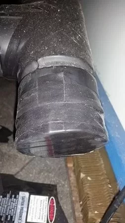

Any 45*, 90* or clean out T's will most likely leak so wrap them well with silicone tape around the joints. At the end of the clean out T, wrap that whole bottom piece else it will leak. I wrapped around the pipe, 1-2" up from the end and again around the rim/edge. Then I stretched short pieces of tape across the bottom, then wrapped around the diameter of the pipe to trap the ends of the short pieces.
I this picture, you can see both the cleanout end and part of the joint wrapped.
