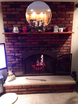

Heres his fireplace, the brick will be covered with ledge stone tiles after, so there will prolly be a granite border around the opening 1st. House is a 2200sq' split, but hes not looking to heat the whole house.

There are plenty of good brands out there. There are two styles, flush and those that extend. The extended models are larger. Go for the largest insert you can get otherwise you are not taking advantage of the max BTU when you need it. You will pay more for the Cast surround models that have nice designs as they are more attractive to look at vs the flat surround plates. Look around online here and you'll find what you are looking for.

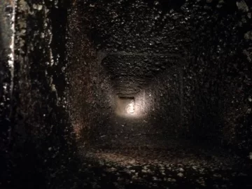

Ok heres his chimney. 11" sq inside diameter. I guess insulated 6" will fit in easy? Its 21' from top to bottom of fireplace. The damper is offset a little and you can just see it in the bottom right of pick.

that chimney needs a good cleaning before a liner is put down it!!
Reactions: pen
I know right! I dont think he did it last year!

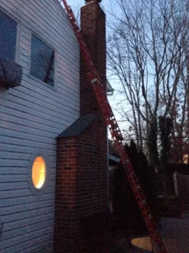

The chimney also moves which cant be right! Is there a strap that can be installed and lagged into the ridge beam? The brick and all look good with no stress cracks i can see of.
Have the chimney and fireplace cleaned and inspected and go from there. I installed a Jotul Kennebec C450 in my fireplace about five years ago, which was a similar size. There are pictures in my install thread. It is not that difficult to do yourself if you have some mechanical aptitude.
he hasn't had that chimney cleaned in a long time. The chimney should not move something is definitely wrong. look for a good sweep in the area try csia.org and get a inspection done before he goes any does anything.

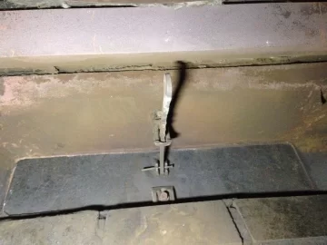

Ok chimney cleaned, we ended up using some heavy galv steel strand cable i have, Used some turn buckles in the attic to pull it tight to house. Heres a pic of the damper, does the whole assembly get removed? [Hearth.com] Helping a buddy choose an insert
Damper door comes off, and if the 6" still won't fit through and get to the outlet straight, then get the sawzaw and angle grinder out and cut it out large enough for the liner to drop through and into the stove outlet.
I bought a 6' section of aluminum flex duct flex from Home Depot to use as a guide as to how much to cut out. Note, the aluminum duct was only to use as a guide, not used in the final set up!
Ok cool so i dont have to rip it all out! That looked a little harder!
Nope, just remove what you need to get the liner through and in to the insert outlet.
The make and install a block off plate around the liner, and your good to go.

That seems to be the standard answer in my area from sweeps and installers as well. I have even gone back for one friend of a friend and helped him remove his "Professionally" installed insert to add one. Like Hogwildz says the damper plate is made to come out by hand. The most you may need to remove is a piece of the damper throat which is easily done with a 4 inch electric grinder and cut off wheel. You may not even need to do that step if the opening is big enough.
