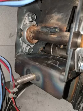

Its not really a pot. I can't say for sure on the Absolute 43, but I think all Harmans use somewhat the same feeder weldment; that said, when looking at the back of the stove there will be a cover that is held in place with a wingnut, remove the wingnut, remove the cover and you will see the fines. BTW, it will be on the left side facing the stove from the back side.

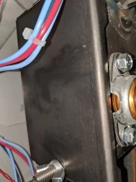

It is the rectangular cover right behind the circuit board

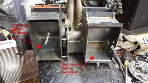

This is the left side of the feeder weldment; old style on the left, new style on the right. The cover is held on by a wingnut, once you remove the cover, you will see where the fines collect. [Hearth.com] Here's a funny one and question

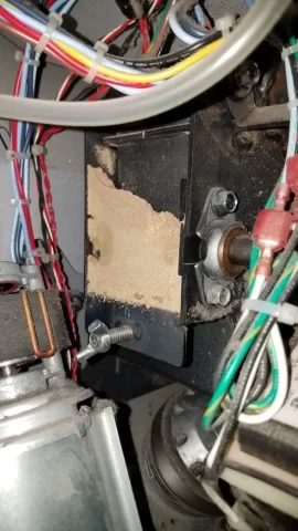

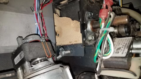

Here is the fines box on my Allure should be very similar or the same on the absolute. Access is from the right side of the stove looking from the front

BIG THANKS FOR THE ASSIST. No were in my manual or online vids did I see anything about cleaning the FINES POT on my Absolute 43. Threw it out in this forum and found out there is a FINES POT and it needs cleaned. I am anal about keeping my stove clean and needless to say when I found the FINES POT and was a wee bit upset when I took off the cover and found this. Had the stove going on 4 years and this has never been opened. It contained what you see and backed up to the auger. Needless to say this will be cleaned every couple of months not. Again, Thanks!!!!
