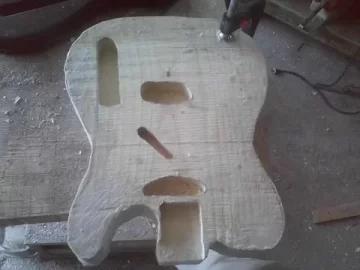

If you cut a plank from a dead tree, do you have to paint the whole board to keep it from checking?
Post has been deleted now.
No,just the end grain & any knots,burls or irregular grain to slow down the rate of drying..There's still quite a bit of water in dead trees of a decent size.The first log I milled was a from a giant standing Red Elm I dropped in Nov. 1993.Dont know what the moisture content was,the tree had been dead over a year with all of the bark gone from branches & most from the trunk.But it had to be at least 30%.The tops & branches up to 10" were already bone- dry & ready to burn.
Depends on what Iam making. Guitar bodys kiln drye for example..... Everything but the middle is coated in wax. Even the dugouts are wax.
  • [Hearth.com] Heres a walnut for ya smokin
