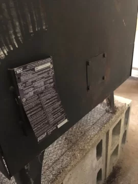

Secondly, there is a small plate covering a hole at the back of the stove (pic attached). Is this for outside air, and should it in fact be covered?
