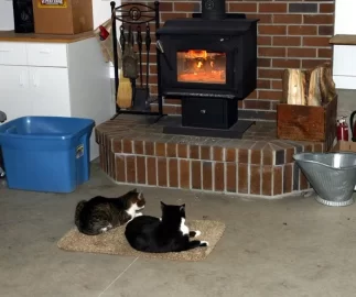

Both of my stoves are on 12" raised hearths. I like it a lot. Could even go 14" or 16", but 12" is a convenient height for a mason to build to with common brick. Rick
  • [Hearth.com] High Raised Hearth in our new home?
Tall hearths were always common in bedrooms so you can enjoy the view while laying in bed.
Then, people started getting old and found it was much easier to load and care for the stove like the guy above in Bend, Oregon, if it was raised.
I like the idea a lot and wish mine were.
