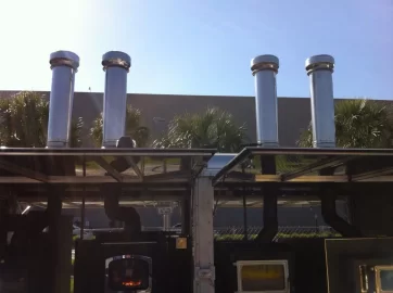

All 4 of these flues are running a Hitzer coal stove. There was never any smell or smoke. The inside of the caps weren't even discolored! They have been running for 2 days straight at this point. I think anyone that has kicked around the idea of a coal stove should definetly give Hitzer a good look!
