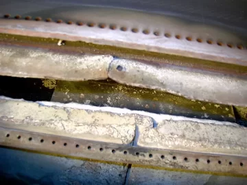

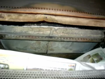

So I bought a used Regency 3100. It looks to be in fair condition and does not appear to have had much use. So, after further inspection upon getting it home, I noticed this weird peice of "damage" at the top of the firebox, all the way up front. Any ideas if I should be concerned??

As for the damage, not really sure with the pic. Does it look like it was cut or something?
It kind of looks like someone tried to pick it up by that lip, but its really hard to tell. Does that lip run straight across?

You'll want the proper baffle in place before burning and that air deflector will need repairing. Not sure what did this, but it looks like a blowtorch like flame severely overheated that area. Check the stove door gasket and glass gasket for any leaks up top.
ughhh, this stove is quickly becoming a lemon. So I am going to order the baffle, which isn't too bad, but what is the purpose of the air deflector? Who would be able to repair something like this? Looks like it needs to be welded....

My stove has similar warping of the sheet-metal part, although not quite as bad. I used a hammer and dolly to straighten it out. I think I used a torch to heat the metal up to make it easier to straighten. That piece is a bit on the thin side for the heat it sees. It will get quite red hot during operation.
Do you happen to have a pic of yours?
I might be learning how weld here soon. Probably cheaper to buy a cheap home welder instead of having a stove guy fix this.
I would try heating it up and hammering it straight first. If that doesn't work, I would get a strip of stainless steel and just screw it to the existing piece. I think it can be fixed without welding.
Thanks! Part of that strip of metal is missing completely. I thought this was a lightly used unit, but the chimney guy said it had fair use. I wonder if the previous owner painted it or something, because the exterior looks great.
So, I got my baffle and the material needed to fix the deflector, which should be pretty easy.
