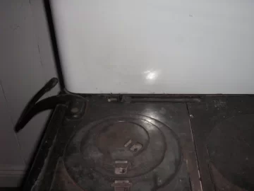

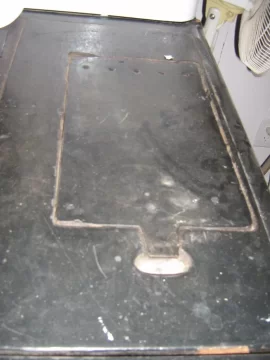

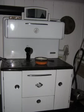

Hi
I love your blog ! you help me a lot before, my English is poor , sorry! but I hope you understand me !
I move in new house, in the place I have a wood ‘cooking’ stove Belanger with boiler
I d’ont understand the ‘key?’ could you help me?
I put picture
If I want save wood , how should I place the key for better performance? Right or left ? and the boiler is it true if I not put water I will break it?
thak you very much !

Hi Annie,
Me too, I have an old Belanger wood stove. The boiler does not have to be filled with water to use the stove, leaving it empty won't damage it. The key that you have on the wood-burning side is for flipping the iron plate over to open up the wood burning part and put in larger pieces of wood. Remove the round plates first and then flip it open.
Quand c'est un Belanger, c'est pas necessaire de rempli le 'boulloir'. Ca function tres bon sans l'eau comme un poele au bois. Je save pas le function de la cle dans le photographe, je pense que c'est pour ouvrir le boite du feu (enlever les plats du fer) et pour mettre du bois plus gros. Bonne chance.

Thank you for your french French :)!!!Ok for the boiler empty ,I have both smoke and CO detectors , the key is not the big one on the right, i know is for flipping the iron plate, but the little key just at left in the picture on the middle

Hello Annie,
It's a metal slider for the oven, when its at the extreme left it closes the metal seal for the oven so little heat gets into the oven, slide it right and it opens the metal partition inside and lets heat into the oven side. That way you can use the oven when its heated up. Use an oven thermometer to test the heat, or you might have a working one on your oven door, by the looks of it. Good luck.
C'est un curseur en métal pour le four, lorsque son à l'extrême gauche, il ferme le joint d'étanchéité métallique pour le four si peu de chaleur pénètre dans le four, faites-le glisser à droite et il ouvre la cloison métallique à l'intérieur et permet de chaleur dans le côté du four. De cette façon, vous pouvez utiliser le four lorsque son chauffé. Utilisez un thermomètre de four pour tester la chaleur, ou vous pourriez avoir un fonctionnement sur votre porte du four, par les regards de celui-ci. Bonne chance Annie
