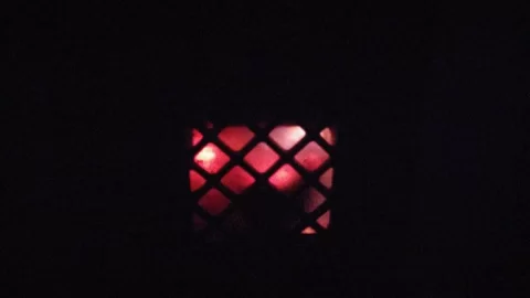

Holy crap, HOT F602

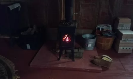

We use it in a very small cabin on weekends

@begreen , tried shutting the flue damper last night, but maybe too late in the burn (stovetop 500's). Still didn't seem to do a ton. I did then shut down the secondary air, which helped more. But really, at that point there is very little air that should be entering the stove. I have been burning mostly liberty bricks (maybe 3/4) just for reproducibility, but that could have something to do with it. A few other thoughts for now:
1. Wondering if my 5" /27' chimney has something to do with it? Most use 6" with an adapter to the stove. Don't know if this increases or decreases my draft.
2. I have zircar panels for the side burn plates rather than the stock cast iron.
3. Lastly, I bit the bullet and ordered a new entire upper burn chamber. Unfortunately that's going to involve another near complete teardown to install. But I'm still wondering if unregulated secondary air is my problem. This should take that out of the equation.
4. I've replaced gaskets about a zillion times, but we'll have new ones for the rebuild.
Well, have had some time since the air chamber install. Basically not much difference in the burning. Stove rebuilt, fired, then gaskets replaced (still no difference). I'm pretty confident at this point that the stove is in proper shape. I did re-introduce the air gap in the front glass per factory specs, so that's letting in more air than before the rebuild.
What I'm doing now is closing the flue damper completely. I can have it completely closed even from a cold start, but it takes longer to catch. I'm closing it early though, then closing the main air control to keep the fire just above a smolder. It usually still ends up all the way closed when using bricks/super dry oak, otherwise maybe open a sliver. Doing this I can keep the cookplate in the 800's, and the temps right behind the plate are in the 7-800's at the hot part of the burn. Seems like I end up with a firebox of coals doing this with temps ~500's for a couple of hours after the flames die out, and it takes much longer to get the stove up to temps. If I'm home, I open up the air fully at that point.
If I wait too long to turn down the air, or let the flames get going, I still top out in the mid 900's on the cook plate.
Keep in mind, this is all with the flue damper completely closed.
