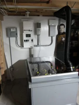

2kw generation. 740 amp/hrs in the 24v bank.
Nice install! What incentives/subsidies does Massachusetts offer for solar installs? Is that grid-tied, or a standalone backup?

2kw generation. 740 amp/hrs in the bank.

Technically no. I must physically flip the switch from grid to inverter. But it is a battery bank connected to an inverter. Just happens to be charged by solar panels.
Reactions: SmokeEater
Off grid. I believe it was a 20% rebate federal at the time. Do not recall the state incentives.
Reactions: chken

In the interest of not totally hijacking this thread, sorry OP, I wil provide the calculation to determine how much runtime you can get from a amp/ hr battery rating vs load.
In my case the XXV draws 120 watts max (no igniter). This is all fans and auger moter running.
So first thing to calculate is the amperage draw for 120 watts on a nominal line voltage of 120v.
Amps=watts/volts. So the XXV is drawing 1 amp.
Next determine the amperage draw when the source voltage differs because the inverter must step up the battery voltage to 120v. The conversion is Batt Amps Draw = Amp draw @ line voltage * ( line voltage/ batt voltage) .
So the in the case of a 1 amp source draw the inverter must pull 5 amps from my 24 bank to supply 120 volts at 1 amp.
To calcuate total run hours ( complete discharge of the bank) use the equation RunHours=BattAmpHours/DrawAmps.
So 740 amp/hrs / Amp draw = 148 run hours. I would never take the bank down that far. Maybe 50% depth of discharge. So 148 * .5 = 74 hours.
Now the experienced may note that there are many other variables that come into play here when we start talking discharge rates. These Maths do not take into account battery discharge for different C rates (amp draw) or battery temperature. But for anything under the C20 rate they provide conservative values on quality deep cycle batteries.
