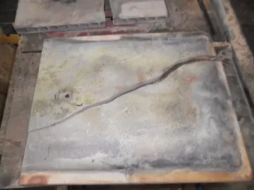

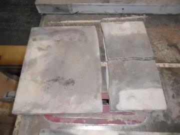

    I built this up-draft gasser. boiler and all in all it works great, But, the panels i have to seperate the chambers only last about 4-6months? I tried cordierite 3/4thick and corelite 1inch thick, both cracked?? I been told from the color on them it runs 1700* to 2000* they are 12x16inch and 14x16inch in size. I am thinking of just putting steel or stainless but this would melt or break down,right?
    I read about Silcon carbide but cost alot and did not seen to have good specs? Any ideas of what to use?

    I've had much the same problem with materials in the secondary chamber. It's a remarkably hostile environment - high temperatures, extraordinary temperature gradients, nasty chemistry, rapid temperature changes. I've turned a lot of expensive materials into gravel.
    The only thing I've found that holds up for any length of time is 3000 degree rated high density / high alumina firebrick. I buy them as 'splits' - half thickness.
    There HAS to be castable ceramic that will hold up, but I haven't found any.

    Might help to use several small pieces rather than one large. The temperature gradient between the center of flame impingement and the edges can be truly extraordinary.
    Of course, my experience is that if you start with one large piece, you end up with several small ones anyway :-O
