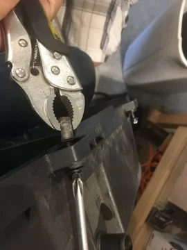

Pic 4 - Cutting the head of the bolt off
Pic 5 - Pulling the threads out

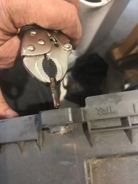

Pic 6 - New OEM bolt. About $25 for 5 that is $5 each!!!
Pic 7 - Decapitated old rusty bolt - Parts man at Honda Dealer said these bolts are always breaking when servicing them in the shop!!
Pic 8 - Screwing in new bolt into metal sleeve that pushes into housing so bolt does not fall out!

Before putting the new bolt into the housing and metal sleveve, we sprayed the inside of the sleeve with WD-40. It was tricky because we had to push the metal sleeve out of the plastic housing so we could get the vise grips in the end of the sleeve to hold it so the new bolt could be screwed in all the way!!
Pic 9 - Banging sleeve into plastic housing
Pic 10 - bolt sleeve in housing
Pic 11 - Pushing head of bolt into sleeve so the top of the bolt that has no threads, turns freely in the metal sleeve in the plastic top housing.
