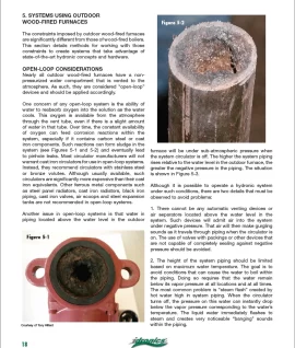

Most (if not all) OWBs are not closed systems, so there is a constant supply of fresh dissolved oxygen in the water. Indoor boilers are designed to operated with closed and pressurized hydronics, so that the water quickly becomes oxgen depleted and causes virtually no corrosion. Connecting your OWB directly will cause increased corrosion of your existing boiler as well as any other steel or iron components in the system such as circulator pumps.
Perhaps you could slow the rate of corrosion with appropriate water treatment, but the preferable course of action is to use a flat plate heat exchanger so the oygen rich water causes corrosion only in the OWB.

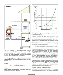

Aside from voiding the warranty on your equipment that was designed to be pressurized, and the corrosion of ferrous components, flashing to steam is possible.
You have the potential to pull sub atmospheric conditions in the upper level piping. When you do this you lower the boiling temperature of the fluid. If you run the un-pressurized heater at elevated temperatures, above 180, then you could experience flashing.
