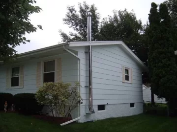

Duravent GS (the pipe you linked to) is Direct Vent gas pipe. If your venting a wood stove you need class A chimney going up the side of the house. (Duravent builds Duratech chimney and DuraPlus chimney) The chimney must extend 3' beyond the roof line and be 2' higher than anything within 10'. You cannot terminate in the manner described with a wood stove. A wood stove requires natural draft to function.

For a wood stove your set up would look more this the picture below with class A stainless steel double wall pipe .The pipe shown in the pic below is coming from a basement stove.
Its best to run the pipe inside the house with class a and then throught the roof to keep more heat in the house and a lot less chance for the pipe to cool off.
