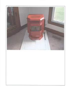

Here is a pic.

Looks like this is the manual for your stove. Going by the picture you posted anyways.....
http://www.lennoxhearthproducts.com/resources/manual/775097M%20E-%20Adv%20Optima%202&3;(II%20&%20CO).pdf
I think ya better wait for one of the more advanced guys to get on here. Hope this helps!

That's a Whitfield Quest. Can't say for sure what would cause it to be unusally warm in those areas though. I think that the combustion gasses take the path your saying is hot. I would clean everything out also check the owners manual and compare it to what you have there. Are you missing any insulation anywhere?
