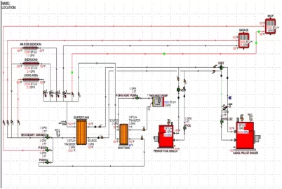

[Hearth.com] hot water heater for storage
Vent on the top, it's not exactly the same as in the diagram (the software didnt have a tank set up this way). This tank does NOT have an internal coil in it, the boiler water and tank water are all the same.
Also, that aquastat at the bottom is not used to turn the Kedel on, it turns on the oil boiler if it's too cold for 10 minutes (a timer is wired in with it). I will move this sensor to the Kedel itself later when the heating season is over and I can put in the correct style thermowell that holds the aquastat right.

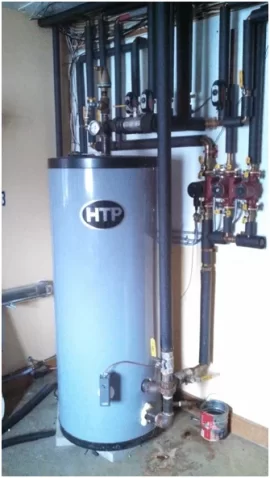

That's a fair amount of piping.
But it is acting as a boiler, so that's to be expected.
The only question that popped into my head, and it wasn't brilliant, was 'what kind of insulation is that? It kind of looks like the usual gray stuff from HD and the like, but maybe it's that more expensive rubbery stuff for A/C. I wasn't happy with the way the gray stuff didn't prevent condensation on cold water lines in my basement that was too damp last summer. It also melted when it got near the boiler outlet. And I did a great job mitering the elbows and everything-I think the foam is porus. I've had the rubbery stuff near the boiler for a while now and it hasn't melted.
I got the insulation from F W Webb which is a regional commercial supplier. Its 1/2" thick foam insulation with self adhesive strips with an R value advertised of 3.2. The HD stuff is 3/8 usually. I have that thicker foam rubber like insulation on the 2 boilers piping which is all black iron to the ceiling. I started with some reclaimed fiberglass insulation reclaimed from demo'd projects at work, but I sadly got the wrong sizes or not nearly enough in the right size. I used some of that on a few short sections and couldn't believe how cool to the touch they were. The foam feels like 90*f or so when circling water. The fiberglass is encased with a reflective foil facing inward which helps with radiant heat loss tremendously.
I will be paying more attention in the future for demo'd insulation on piping systems at work. My next house will have as much of that as I can find.
And your remark about it being like a boiler is an excellent way to describe it really. Its the distribution point while the oil and pellet boiler simply supply the heat to it.
It's amazing how much all the miscellaneous crap costs. And you're talking next house. :)
