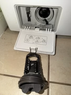

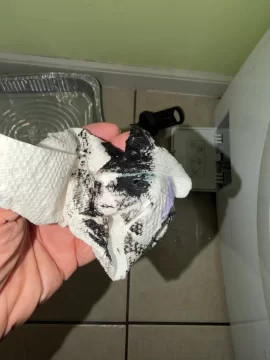

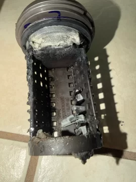

This time we checked and found the LG washer has a filter behind a small panel in the bottom front left! I checked and found black slime in the filter so asked Google?
Does the LG front load washer bottom right filter black slimy substance inside attract drain flies? !!!!!
Yes, the black, slimy substance in your LG washer's drain filter absolutely attracts drain flies. This substance is a mix of mold, mildew, hair, lint, and built-up laundry detergent/fabric softener. Because it is damp, decaying, and nutrient-rich, it creates a perfect breeding ground for drain flies and other pest!
I cleaned it out and the laundry room smells better already!! We have a cleaning packet to run a clean cycle now. Then I got the Green Gobler in to catch anything that went upstream or downstream to finish the job. :-)
Anyone else have this issue? See pics of washer filter below.

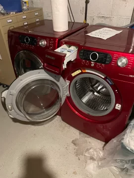

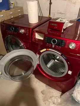

I have the LG front loader washers too. Yes you need to clean that filter every few months at least. That's what it is there for. You drain the washer by pulling the little plug on the black tube right next to the filter. And then open the filter and only a small bit of water will come out then.
Using a cup or 2 of dish soap like dawn or similar in your drains works great to clean and prevent grease clogs. Pour it in and let it sit overnight for best results. Then nice Hot water rinse.
Also borax should treat the fly problem and also help clean drains. Not sure on the ideal dwell time for borax though.
Also Borax as a laundry detergent booster works great to keep you washer clean and get smells out of your clothes. Don't use too much and some washers may need you to dissolve it in hot water before adding it to the tub.
My Samsung front loader can take just the borax powder right on the rubber door seal, but my LG front loader has a different water fill path and the borax doesn't seem to get dissolved fast enough so pre dissolving it in water works better.
I would guess i'm using a tablespoon or 2 when i do use it in the front loaders.
Also always leave the washer door open all the time to dry out to prevent mold. And i always pull the detergent tray and dump the residual water after the washer is done for the day. This greatly slows the mold growth in that compartment's walls and i'm sure further down the hoses. I also always leave that detergent tray open to dry out. (I actually do leave it on the counter or on top of the washer and only put it back in when we use the washer again.) Our basement is humid so every chance to dry things out is helpful to keep mold away.
