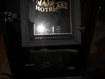

Hi, I'm a newbie at this and I'm having trouble keeping my fire at an even temp. for a long period of time. I have a good draft for the chimney but still have to fool around with the spin draft.
Also, what temp. would be considered in the dangerous zone? I have the thermo. on the front just above the loading door.

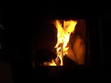

I took my loading door damper right out and sealed it shut and only use the ash pan screw damper. When I load, I put 2 logs side by side front to back with about a 1/2 inch gap in the middle and the flame burns slowly up the middle. For longer burns, I will also put a large round on the right or left on top of 1 of the bottom logs, but against the wall instead of the middle. This way, once the middle pieces crumble, the one against the wall will fall to the bottom and burn. These things are drafty, if I have a hot bed of coals, I load it and shut the screw damper all the way, and it still keeps burning, but very slow. I had to install a damper in the chimney as well so I can shut that if I ever needed to put the fire out in a hurry. If you install the forced draft kit, I think it would let even more air in, even when the blower isn't running, so this may add to your problem. I took some pics because I just loaded it and I have some time on my hands ;-) The fire looks raging, but it's because the door is open. Hope this helps.

I have the forced draft. It never runs, but I keep the flap open on the blower on the back. This allows for secondary air. I have a thermometer above the door and I can burn mine at 500, had it to 600 when real cold. 400 would be about normal. I load mine up, open the ash pan damper all the way for about 20 minutes, then I close it to 1 turn open. It will burn with no smoke at all from the chimney all night, and run around 400 to 500 through the night. Right now its 23 and windy, the house is 78 degrees. It takes alot of getting used to. If you don't have the rear plug open, I wouldn't recommend to damper it way down. It wastes fuel, and creates a dirty chimney. I get a nice clean 8 hour burn at night. Rather do that than a slow 10 hour burn, with not enough heat to keep the demand, and a dirty chimney. You'll learn how to regulate the temps. When its real cold out is when they operate the best.
There is a huge learning curve with these. I have to damper mine down because my chimney is packed double wall with no bends, so my draft is probably more than a masonary chimney would have. If I did anything more than 1/4 turn or so, it would be almost 80 in here too and we wouldn't be able to sleep or be comfortable. I'm burning at 73-75 most all of the time...see pic with low and high for the past 24 hours. Just keep messing with your damper until you're comfortable. Check your chimney if you are worried about it, but I haven't needed to sweep/clean mine in 3 years of heavy use.

I'm burning wild cherry and maple. They are larger splits, around 6 inches. When it gets super cold, I burn the locusts at night, and I choose only rounds. Try something, remove the rear pipe plug and keep that open. Then keep the door damper closed, and regulate with the ash pan. On my unit there are 2 or 3 little holes on the damper in the door. I peek through those to make sure I have a solid flame at the baffle. Instead of burning the whole pile at once, It will slowly burn at the bottom, and I get flames above the wood. It will burn for 2 to 3 hours before the wood on top will start to catch fire. Meanwhile it will have a temp of 400 to 450. Once you have a good coal bed, I would load, then run the spin damper open for about 15 minutes. From there, you can shut the ashpan damper down to around 1 turn open. By almost closing the ashpan damper, and having the door damper closed. It will force air from the back of the firebox right below the baffle. This is where you will have your primary combustion. It works well for me. Took a few years to figure it out. I was going to put in secondary burn tubes, But I might not because I get the same effect by closing the ashpan down. One thing to keep in mind is I need around 350 on the front of the furnace to keep a good secondary combustion.
