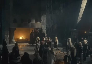

Yes, this is purely curiosity, and yes, I get that it's a TV show :)
[Hearth.com] House of the Dragon fireplace - doable?
Assuming enough sq ftg, and ceiling height, is a fireplace that big doable in a residential home interior? My cousin says no, that the damper can't be that far away from the flame.
Thoughts?

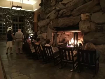

This fireplace at the Grove Park Inn is about that size. The lintel is taller than many people.

They absolutely exist. And most absolutely smoked in the house some as well
