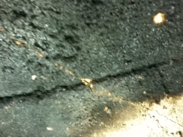

If I've gone over every surface with a wire brush and gotten all of the big stuff, i.e there are no chunks of creosote left on the walls........you know what i'm going to post a couple pics up here tomorrow that will probably do the trick!
Thanks BB
here re the pics

the whole smoke shelf will also have roxul packed into it, so the chimney will not be touching any of the are ain the pics/video and will also have roxul between it
What I am seeing is most of it is already charred. I would just hit it with the long handled wire brush, the same thing a sweep does, and call it good to go. Most is just a thin coat and I bet the thicker stuff comes right off with the brush.
