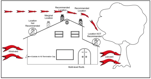

Every roof is different, every location is, too, regarding wind direction and speeds and so on. Wind blowing over the roof ridge line and/or around obstructions near or on the roof creates turbulence. Even a hillside near and upwind of the roof can cause this. Or another building. If the chimney is too short, the opening can be located within that turbulent zone and this causes problems with draft [or it can] and other things. You need the top of the chimney to be up and out of that turbulent zone.
The 2' above anything on the roof within 10' [some sources say 3'] is a generalization. Sometimes 2' or 3' isn't enough.
