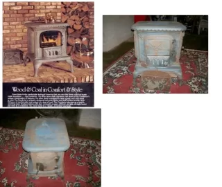

I have an old Comforter stove with no legs. I found some legs that would fit, but not sure how to attach them. There are holes in the top of the legs to screw them in, but no matching holes on my stove. Is welding the only way perhaps?

Thanks. I thnk I'm just going to forget these legs - probably too much trouble. My stove has a one threaded hole under each corner about an inch or so away from the sides. So I reallly need legs with just one hole on the top to bolt in. The ones I have look like they are made to be screwed or bolted into the edge of the stove on the bottom. Thanks for your replies, but I think I'm not going to mess with this!!

There are definitely some tapping (threads) in the bottom of that stove - probably 1/4" or 5/16", which are designed to take the legs. You can probably buy the original legs - but they will cost big.
The usual way the stock legs attached was through either an oversized cast or drilled hole in the leg - or it was sometimes just a slit, and then a large washer and the bolt. You can probably modify a set of legs with similar properties - as long as you somewhat know what you are doing. You certainly don't want the stove to fall over once it is burning!

Yes, I'm going to look for some similar legs. Don't know where I would get original legs. I have not been able to find any. Thanks!
