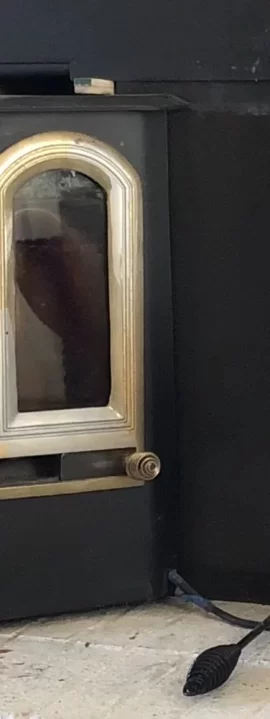

Needing to replace the glass seals/ gaskets around the bay windows on our Sierra insert and cannot find a thing on how to remove the windows! All the videos show the process AFTER the window/door has been removed!

Usually this is done from the backside by removing retaining clips or brackets.
I have a 1980 Sierra free standing stove. Not the same but I had two screws on the inside holding my glass with a washer.
