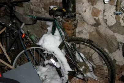

Last year I went to my basement for a bag o' pellets and saw a snowdrift inside......... It was a goodway of finding a leak in the foundation...... Alright the pics posted backwards but ohhhhhhhhhh well..... I redid the foundation after this happened.....
