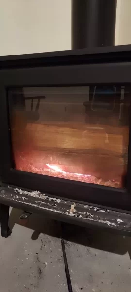

Here's ours tonight, second pic is about a minute after I loaded it. I'll let it go for about 10 to 15 minutes before I shut it back. Please ignore the mess in front.
[Hearth.com] How do you load your GM60 stove? Looking for pictures [Hearth.com] How do you load your GM60 stove? Looking for pictures
