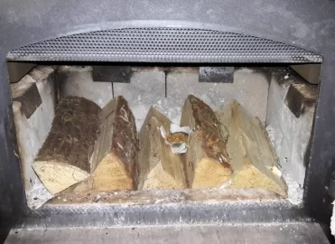

A row of splits NS.
A sawdust & wax fire starter cradled between middle 2.

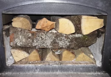

A row of EW splits with a gap for the flame to travel up.
A row of NS (usually smaller pieces) above that, with gaps for flame.

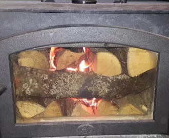

To go with my post above...
[Hearth.com] How do you start your burns? [Hearth.com] How do you start your burns? [Hearth.com] How do you start your burns?
