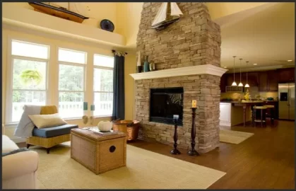

We have a '61 ranch home and want a wood insert into our existing rock fireplace - which is smack dab in the middle of our living room / dining room / potential one day to be expanded kitchen area. (I don't have a pic of ours, so I'm attaching a slightly similar one to give the general idea. Note, however, ours goes all the way up on all sides, not just one side.) Currently, the fireplace is open on the living room side only. We have all electric (and can't get gas and don't want gas) with a heat pump that has trouble getting to temperature even in the 40s, and the house seems chilly even when the thermostat is set to 72, especially in the family room, which a previous owner had converted from the garage. The Wonderluxe woodstove (apparently B2350), in the "garage" side of the house does help when it is on, but doesn't seem especially environmentally friendly - plus, the inspector said we should remove it for some reason or another (and think it was because it was allegedly not functioning, which, obviously, isn't true).

Zero clearance fireplaces are different that wood burning inserts. Inserts can only be installed in a code compliant masonry fireplace. Zero clearance units are framed in.
I know of no double sided inserts.
First step is to confirm what type of fireplace you have. A picture with measurements is helpful.
