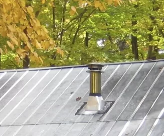

Long story short, my chimney is runs about two feet above it's base on the roof and I think I need to add another three feet to be legal for my new install. That would put me two feet above the roof peak which is eight feet across.
(Don't I need to be two feet above the peak using the 2/10 rule?)
Can I run the chimney five feet above the roof without using a brace. I much prefer to get higher without the need of support.
Anybody know about this stuff?

Yes you need to extend the chimney and yes it will need a brace. One is required for every 5 ft in pipe height I believe. If you get a big storm and it's blowing strong gusts, you'll be glad it's braced, especially if the stove is going!
At least 3 feet higher than the point at which it exits the roof, and at least 2 feet higher than anything within 10 feet of it horizontally. Rick

I was hoping that I didn't have to install a brace - but I guess BeGreen is right - I'll be a lot happier when the wind is gusting.
My current chimney seems fine and I have a metal roof, but I want to be legal so if I burn my house down I'll be covered by insurance.
Is the brace just a matter of screwing into the roof and patching the screws with roof cement?
My pipe ends up being 4'10" so no brace is used :coolsmile:

You can get pipe in shorter lengths. If you need only a couple feet to make it a legit install and it falls under the 5', then you won't need the brace as Zamboni pointed out.
If you need the brace use neoprene washered screws and make sure you hit some wood lath under that metal roof. Just into the metal alone will most likely pull out in time.
Don't use roof cement, use a good caulk either silicone worked in real good or urethane.
