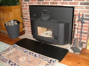

Here's a picture of my stove with my new hearth rug I just picked up today. The guy at the fireplace shop told me the carpet would take 10 to 15 minutes with a hot coal directly on it to catch fire. The hearth rug will protect the carpet. Because I don't have a raised hearth, the extensions would look stupid, the only other option I have is to remove the carpet.

What inspector passed that installation? Code requires hearth protection of 18" looks like you have about 6"
no wonder it hot there
Hearth rugs do not satisfy or substitute for clearance in front of loading doors requirements.
You could cut up a section of the carpet and either lay tile directly over the floor, or also cut up the top layer of floor and build back up to make a level extension.
Search this forum for "hearth extension" and "building hearth" and you'll find plenty of threads about people who have done just this (including me).
Not sure if this will satisfy the code or not, but you should be able to add another course of tile easily enough. You could probably match it pretty close to your existing tile so it won't look bad. Or just have the existing replaced too. Could do a nice semi-circle or something. Shouldn't be too expensive either. Make sure to get a few quotes.
I wasn't aware of any inspection requirements, I installed the stove and stainless liner myself. The fireplace was existing, the original hearth was only 12 inches deep. My hearth tiles are ugly as sin and I'd like to replace them anyway. If I pulled my carpet back 18 inches and used an 18 inch deep stove board, would that satisfy code? I'd like to extend the hearth but between the stove, liner, and new log splitter, I'm broke so the hearth's going to have to wait. Who does stove inspections in PA, and who requires it? Homeowners insurance?

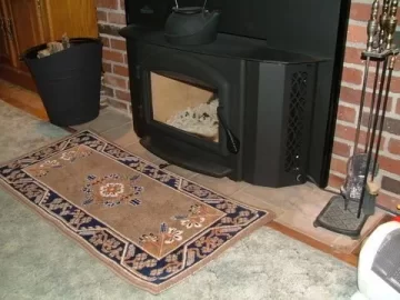

I appreciate the info guy's. How's this Inspectors? The carpet is 20 inches from the front of the stove. That's an approved hearth extension 18 inch by 48 inch and a wool hearth rug. Haven't had my stove lit but I'll bet my carpet stays alot cooler.

This was never a competition, but an informative way to make your installation safer 180 degrees had you worried and you came here looking for advice.
you were correct to question a rug getting that hot Enjoy the full night's rest knowing you are a lot safer now, sometimes I may react with a sledge hammer to drive a point home, But if I did not care, I would not bother I guess i could use tact lessons .Sorry if I dropped the hammer on you If you think I was rough, be glad that stove was not a Vogelzang box stove
welcome to safe burning
