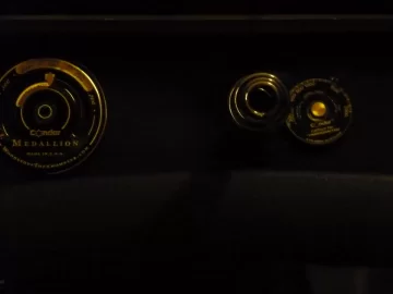

It's harder to get stove temp on an insert, but you can put a thermo on the door or shoot around on the stove in various spots with an infrared thermometer. On the Buck 91, I had a surface meter on the front, about where the actual firebox top intersected the front of the box.
