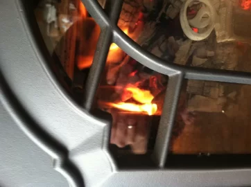

Thanks for advice. Ill try attaching a picture of a phenomenon that occurs sometimes when it gets hot like that. Sometimes it appears that there are flames shooting out of the firebrick. I only notice it in the back corners of the stove and I only see it when the stove gets really hot. Could that be air leaking in and igniting or something else?

Lets not read too much into this.
First, try cutting the air back sooner.
Second, remember the stove likes to run hot.
Then determine if there are leaks. I doubt there are leaks coming from behind the firebrick. Of all the places, behind the firebrick would be the last place I would think about air leaks at this point.

Sounds as if you might have a small air leak somewhere in that area...Shut air completely down, turn stove fan/s an high and ride it out...750 is not too hot for a good stove, even 800+ for a brief period won't hurt, would certainly try to avoid prolonged operation at those 800+ temps.
