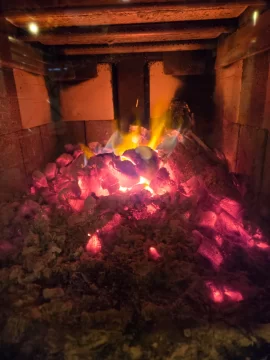

I reloaded my HC last night on top of a bed of coals. Loaded it about 75% full and here it is 10 hours later. Thermostat was calling for heat probably 25-50% of the time. When I woke up the thermostat was not calling for heat so I raked all the coals to the middle and bumped up the thermostat so it would call for heat. 10 minutes after doing that I took this picture. P damper was wide open, G damper was open about an inch.

Oh, and what picture :)
Not sure why, but it wont let me edit my other post to add the picture. Just saw your other response.
Im with you on forgetting that you cracked the ash pan door! Made that mistake once due to having the attention span of a gold fish. Now I dont walk away from the HC if the door is cracked.
Those splits dont too big. I do find that the bigger splits take longer to get past the smokey phase after reloading. They also make it take longer for the unit to heat up. All my splits used to be about as big as yours when I first got my HC due to my old wood furnace being bigger, just like youre saying. Since then ive started using splits about half the size. Its made starting a clean fire much easier and the glass stays cleaner. Cutting the all the 24 inch splits in half really sucked. On the upside the 12 inch splits were really convenient for small fires.

Holy crap that's a mound of coals/ashes! _g So what do you typically do with them when you need to load?
I also have added an extra layer of firebricks on the bottom of my unit so might make it looked bigger than it is. Still a lot of coals though. That was from an overnight burn with close to full firebox. I wait for the coals to burn down then reload when there's a few handful of coals left if my next load will be medium size. Rake them over the grate and reload to start the process over.
