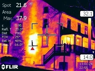

FLIR photos of the outside of my house, with two of my Jotul Firelights running. Both chimneys have insulated liners. Both of these hot spots are thru 18" - 20" of mud-stacked (1770's) stone.
Ambient was 12F, I believe.

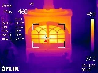

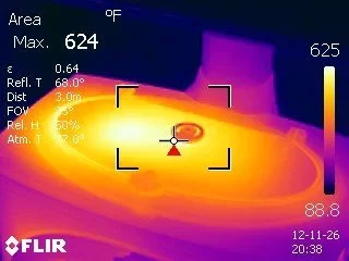

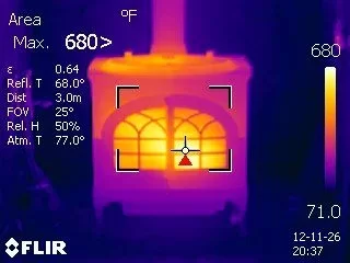

I apologize to the OP for the OT, but... yeah, BK should definitely have one of these. I'll try to get some photos of the Ashford in action for you next winter. Here are some of my first Jotul.

View attachment 158468 View attachment 158469 View attachment 158470
