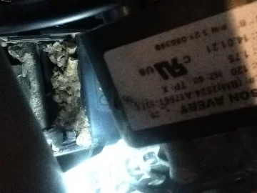

With a sense of dread, I pulled the insert out the first time last weekend. I can tell you for me, the first inch out and the last inch back were the hardest. The upper corner of the cast frame pulled out (put back and retightened thread post) and the probe wire pulled out from its solder less terminal (I reattached taped the heck out of it and will remember next time to watch for it plus the green one that also came out). Anyway, after just 2 tons, things were pretty clean. My surprise was the fines box - pretty full.
Never had anything to speak of in the fines box. Gotta empty the ash pan today. Do the finger pull ash outta the igniter compartment drill. Only one igniter replacement after six full seasons running in room temp mode. Not bad in comparison to most I guess.
Yup, do the finger pull here. At some point, I'll put a small tube on the end of the vac hose. I did use such an attachment when cleaning the fines box as my finger wasn't 12" long nor double jointed.
