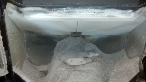

None yet. I just cleaned the Quad after about a ton..
Just a "lil" ash build up :)
(Click to enlarge)
[Hearth.com] How many times have you done the leaf blower cleaning this season? [Hearth.com] How many times have you done the leaf blower cleaning this season?
