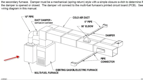

So I am guessing you have a setup similar to the diagram below from the American Harvest 6500 manual with a backup electric furnace. If you can find the model # such as 6500 that will help alot too.

My furnace is a Model 6500 American Harvest.and the heating and cooling installer used the schematic. Where would a thermostat be installed? Do I need one? Also, how is it installed as the blowers run almost constantly. I keep thinking we are missing something important to be burning 3 bags a day when many of you live in the very cold states and burn 2 bags. Our house is 1700 square feet and use the pellet furnace as primary heat. Just took some pics will try to send them.

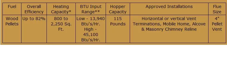

Example:
Avalon Astoria
BTUs Per Hr_Heat Setting___LBs/Hr
13,940 _______LOW_______1.7
45,100 _______HIGH_______5.5
The high setting for my 2,000 SqFt fairly well insulated house is only needed when it is -5 to -10 degrees F below Zero
or zero to 10 above and high wind speeds!
I use the low setting which is almost 14k BTUs per hour for very comfortable heat most of the time when it is 20 to 30 degrees F outside
