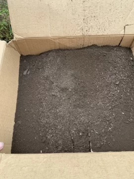

Hey Guys, I installed my Osburn 1800 myself last year using a lot of help from this forum:
My searches here led me down many rabbit holes last season, and I learned a ton about heating your home with firewood, so I threw together this video:
Anyway, I have the wood racks half full, and I'm already thinking about winter. I decided to sweep my own chimney today, and removed the firebricks from inside the stove, and used a 6" poly brush with a 3 extensions to sweep it out.
Couple things to note about my setup:
13" Doublewalled Stainless Liner, from Stove to Chimney Cap, NO insulated liner
Chimney is NOT on outside facing wall, it's sort of central to the house
Osburn 1800 has a fairly small firebox
I would say initially, I burned very dry wood, and the stove put out a ton of heat. As the season progressed, I tried to burn only what was under 20%, but some of it was closer to 20% than 10% moisture content. I also burned anything I could find. I cut down dead standing trees, burned those, had firewood delivered, chopped up a tree earlier in the season and used that, I just burned whatever.
Anyway, I would guess over a QUART of creosote came out, most of it was light fluffy coffee grounds, but I saw a few specks of hard black shiny parts as well. Does this seem normal?
One thing I struggle with is the air adjustment plate... I've posted about it a few times in the past, but I struggle to get more than 2 hour burn times. If I REALLY get it full, I can maybe get 3 hours, but that is absolute ideal conditions and rarely attainable. Thoughts?

A quart is nothing to be worried about at all. The question is was that all of it? Did you go to the top and inspect to see how clean the liner got.

I brushed it from the top. What was odd is that from the top, I only saw buildup near the top 2' of the liner. Looked fairly clean but blackish as it went down.
I was under the impression that creosote only deposited if the liner was cold, and the moisture from the wood caused it to condense. The upper 2' of hte liner would be the coldest, so that made sense to me. I'll post some photos in a bit, it's on my camera

Yes it's perfectly normal to have the worst buildup at the top

You're doing ok. The fire looks fine, and not getting too much air. In spite of what the manual says, this is a small firebox with about 1.1-1.3 cu ft of usable loading space. A 3-4 hr burn time with hot coals for say 5-6hrs is about the best it will do.
Note that moisture meter reading should be done with room temp wood and always on the freshly exposed face of a re-split piece of wood.

I would not be comfortable, on 13 feet of stack, only brushing once a year and getting a quart out, but grey fluffy with a few black specks is as good as it gets.
Can you maybe brush bottom up around the New Year to get the first pint out, and then top down over the summer when the roof is safe to be walking on?

Why would you not be comfortable with that? A quart is nothing to worry about at all.

I appreciate the reality check/ data point. On I think 18 feet of pipe I am accustomed to seeing less than one measuring cup, less than half a pint, of fluffy grey with some hard shiny black flecks after four cords. I guess I am doing pretty OK.

That's pretty remarkable considering how cold the exposed part of the chimney must get. It's about the same as what I see after 3 cords with 20' straight up, but in a much milder climate.

Alright, following up. Just edited my video on my first sweeping! This shows how much creosote buildup was in my liner after 1 season of burning about 1.5 cords of wood.
It seemed like most of the creosote happened way down low, near the stove itself. Up top, there was not a lot of buildup other than maybe the first foot or two. Would this be due to burning some wet wood?

Yes, that is a lot of buildup for a cord and a half burning, but at least it's powdery. Most likely this is due to the wood.
For comparison, we average a half of an 8oz. yoghurt cup a year burning ~3 cords. Most likely this is due to the wood differences. We have been burning doug fir almost exclusively. I am on an every other year sweep cycle right now, but the winter will be different. We will be burning mostly hardwood until probably around Jan or Feb 2022, so our luck may change and soot accumulation may go up. We'll see.

All good points. It seems like that might have been my issue, as at the end of the season I was burning some dead standing stuff that I did not season at all.
Agreed. That is not much fuel at all for a chimney fire, and if most of that was up top it would probably take accidentally leaving the air wide open on startup to even ignite it.
