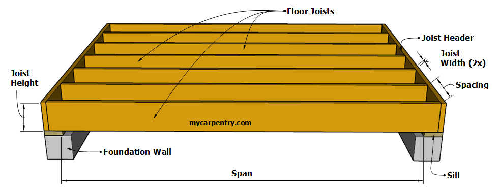

Most deck designs would account for around 40lb/sqft live load. That would account for some furniture, and a dozen medium sized fat guys in on a group picture yet keeping floor bounce to a minimum (live load). This one doesn't appear to be up to current code (joist hangers etc). If it was mine, I would reinforce, at least in the area of the long spans, and keep any wood stacked in moderation. 40lb/sft would mean a cord (3500lb) spread out and stacked at something like 10ft x 10ft x 1-1/2ft high. High load spans, for something like a work shop, shed or garage, or wood storage, can go to 120lb/sft and more, but the joists and supports are designed for such, and not like this for a living area. The weakest part of a span is in the center.

Design tables are such that they try to account for deflection. Back home in the old farm house, they used 2x4s, to span 16ft/2 or 8ft. China cabinets rattled, the floor bounced, the addition is over 100yrs old, so its all tolerated. But by todays standards it wouldn't be right. You may have gotten away with stacking wood on your current floor, but whose to say, maybe it sagged and was tolerated. No one was walking on it, so no rattling china. To stack more, how brave are you. There was another 175yr old house I was in, 16ft spans sagged 5inches in the center. I always knew where the kids toys were.
