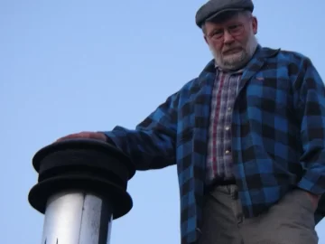

[Hearth.com] how much more efficient is a lambda boiler when run w/o storage?
This clean efficient burn would not be possible without storage. The boiler at the bottom of this chimney is a 32 year old Jetstream boiler - one of the first gasification boilers. The non-gasification boiler before the Jetstream saw a 40% drop in wood consumption with the addition of storage!

More proof that storage actually saves wood...........
Well it allows the equipment to run more efficiently which saves the wood.
