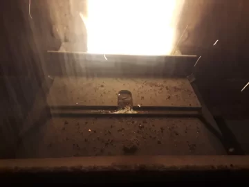

I have a 2006 Auburn and I run pellets in it for what you would call "shoulder season" and run a corn and pellet mix for the colder months.
When I run pellets I use a "pellet pot" which they sold at the time I purchased the stove but I think they have done away with it and just had people use the corn pot. I tried the corn pot but just couldn't seem to get it quite right and I went back to the pellet pot.
On your air intake adjustment on the back of the stove I set it up for corn using the stop and leave it there and when adjusting for pellets (if needed) you can turn the arm in the opposite direction so you don't loose your corn adjustment. Your air adjustment should start open about the the size of a #2 pencil.
If you can download a manual for it (or already have one) that will be good place to start learning about the stove. I use the "leaf blower trick" on mine and it works great to keep the "hidden" passages open on this stove. Somewhere out there is some pictures of this stove that has been cut apart showing the cleaning procedure.
The picture is with the pellet pot I'm running right now.
