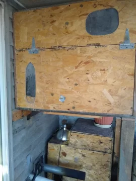

I could not recommend it enough. Anything to lower the workload daily always helps. Here is a few pictures of my setup. Granted I do not clean my corn besides what is blown away in my moving it from the grain wagon to the box on the side of the house. I have not had an issue so far with it.

Just now seeing your corn set up. WOW.
So you fill it up outside and a chute keeps the stove fed. I could never do anything quite that ambitious. At least not anytime soon. A roof that doesn't leak and a basement that doesn't flood every time it rains more than an inch are on the top of the list for construction projects.

Learned the hard way not to reinvent the wheel. Just take other people's good idea's and combine them into something that works for you. For instance to move the corn I use 4" PVC pipe and a leaf blower, got the idea from hunters filling deer feeders. Cheap and easy, just like me, except instead of being easy I am just lazy.

The always inherent issue with moving corn in plastic piping is static electricity. Corn sliding against plastic creates static electricity and it can be a 'shocking' experience. Why I handle it the way I do. The garbage cans eliminate the 'shock' aspect.
