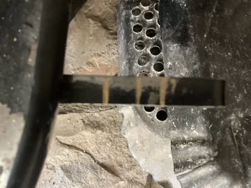

Loaded almost a full load last night. Raked coals to the front, left a channel for the primary air to the back of the stove. Caught pretty quick, had the cat engaged in 5 minutes. Had the air shut down to less than 1/8" open by the time the STT was at 475, flue was at 280. Over the course of an hour the flue dropped to 245 then rose to 410; STT maxed at 730.
Now I've been leaving a pretty big "valley" behind the primary air that extends to the back of the stove (per the manual). 2" x depth of the ash. The bottom of the logs are being fed air and flames in the valley are visible even when I have the air turned down.
I'm wondering if I should just make sure that the ash/coals don't block the air inlet vs leaving a large valley underneath the entire load?
For the final air setting should I be turning down the air until I can no longer see active flames on the load and just secondaries?

The answer to the above questions in black are a resounding "yes". Leaving that large valley underneath the entire load was causing the entire load to off-gas at once.
