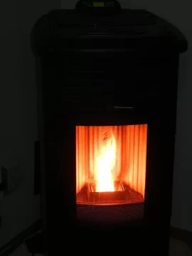

Looks good
Nice wide flame and very lively. That is what you need for good heat!

I'm going to bring up the feed rate in small increments. 1/2hr later it looks like there's only a single layer of pellets in the burn pot. I might be a little on the starvation side. I think the elevation and pipe length is the reason why I am having to make these manual adjustments. Please correct me if I'm wrong.
Looks good

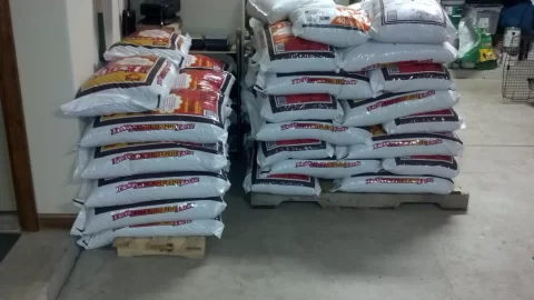

I'm storing the pellets in the garage until I get the second one built. The wife and I are in a constant battle for workshop space so I'm gonna solve that by building another garage.==c

Just got off the roof and checked opacity from the stack. I could see right through the smoke with only the flicker of the exhaust gas as evidence that anything was coming out. 47 outside 70::F inside.

From the looks of the flame in the picture, it appears your stove needs more air.
Umm, I've only been burning one year. How do you know that more air is needed? On startup, I will occasionally have a flame that reaches from the burn pot to the exchangers, but it is a straight bright white/yellow snapping flame. Once the room begins to heat, this dies down to a 'normal' size flame.
Thats pretty common on start up. More fuel is often put to the burnpot than it actually needs. Then burns off.
White/yellow tips and active flame, which is good. Usually see light gray or white ash on glass.
Dark orange or black tips is bad, That is usually a rich lazy fire. Usually see black or dark gray ash on glass.

video of my flame at 2600rpm combustion and 4.1 per 12 sec feed rate. How does it look now?
