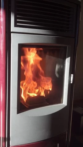

I'm on my fourth burn with this new stove. It's possible that it may need to be tuned but at this point I'm still getting use to how it behaves. I obtained a programming manual but haven't sat down to read it in detail yet. I'm 2hrs into a burn this morning and this 2nd bag of softwoods is a night and day difference from the first bag. I won't be using that wood waste pellet again. I've still got 2 more brands to try after this load finishes, a sawmill soft/hard blend where the blend is determined by what moulding was manufactured that week, and a Lignetics softwood. Just took a pic.
I see the thread posts about the various brands you all prefer and was mainly wondering what drives your selection other than price. So far I've gathered a good pellet can be determined by the amount of soot on the glass, the amount of ash, oh and try as many as possible.

From the looks of the flame in the picture, it appears your stove needs more air.
Thanks for that. I'm at altitude of 7300ft and have a Selkirk DT oak installed(15ft of 3in OAK 4in exhaust) so its preheating the air as it comes in. Any recommendations to get more air?
Doesn't seem to have a damper or setting for air flow. Neither manual mentions this. Correction it does state not to install a flue damper in the venting.
Might have a blower rate adjustment in the controller? IMHO its hard to tell with a pic. Videos are a better judge of flame.
Some stoves(don't know yours) don't have great airwash systems and you need to clean the glass more often. Color of the ash/soot can be a good judge, Light gray is good. Black is bad.
I think it needs more air too. Phil do has a Piazzetta, maybe he can help ?

Found the combustion blower speed setting. The settings are within acceptable operating parameters but there is room to move up. Smoke probe temp was 270::F. 176-353::F acceptable limits.
blower was running at 2440RPM at highest setting P5. Stated limits at P5 are 2410-2800rpm with no factory setting.
Next time it runs I'll have a look and take some video for critique. Room temp got to 81 (42 outside) while I was playing with settings so I had to turn it off. It got the house hot in a hurry.

A white active flame is perfect, with pellets dancing in burn pot. Ejecting pellets out of burn pot = too much air.
Best test will come when it is below freezing. You get to run the stove at optimal levels then. Record both the inside and outside temps at the same time. That is the only way to be objective about how well the pellet is providing heat for your home. Also note your stove settings. Ash and dirty doors are secondary and not an inclusive indicator of how well that brand of pellet is for heating your home. Some brands heat very well, but are very dirty. Not necessarily, or usually the case, but it happens.
